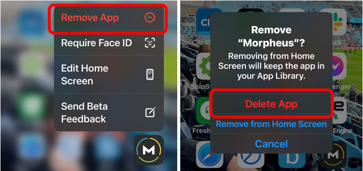

Here is how to delete an app on iPhone:
1. Find the app on your phone’s main screen
2. Tap and hold on the app icon
3. A screen will appear with Remove App as one of the options.  Tap that.
4. On the next screen that appears, tap Delete App
Note:  You will NOT lose any Morpheus data by doing this.
After you have deleted it, go to the App Store and search for Morpheus Training and reinstall it there.
