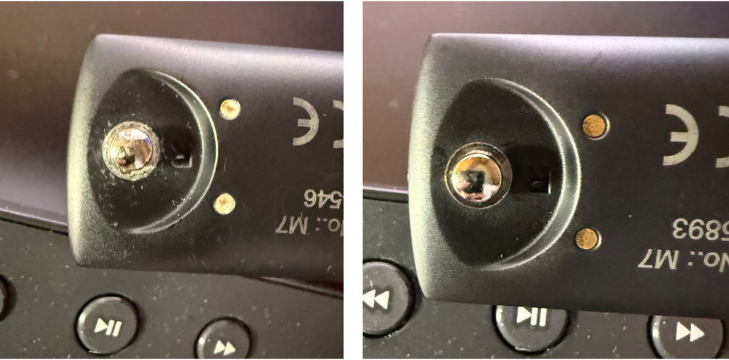

🔌 After Every Workout: Remove & Wipe Down the Transmitter
    • Always unclip the M7 transmitter from the strap when you’re done using it.
    • Wipe the back of the transmitter with a soft towel to remove sweat.
    • Store it in a cool, dry place (not in a gym bag or steamy bathroom).
    • If you’re worried about losing it, consider a small storage case — you can find inexpensive ones online.
Why this matters:
Sweat is corrosive.  Leaving the transmitter attached to a damp strap or not wiping it off can cause:
    • Charging problems
    • Difficulty powering on
    • Connection issues with apps or devices
    • Inaccurate heart rate readings
Real results:
    • A transmitter used only 3–4x/week but never wiped down stopped charging in under a year due to sweat build-up.
    • A transmitter used 6–7x/week and wiped down after every workout still looked and worked like new after 3 years.
To clean the back of your M7, use rubbing alcohol (70–99%) and a soft toothbrush or cotton swab to clean the charging contacts.  Let it fully dry before charging.
Isopropyl alcohol (70–99%) is ideal because it:
  • âś… Dissolves sweat salts, skin oils, and grime
  • âś… Evaporates completely (no residue)
  • âś… Does not corrode metal contacts
  • âś… Is safe for plastics and seals when used sparingly
  • âś… Restores both electrical contact and magnetic seating
Do not use baking soda, abrasive cleaners, or water-based cleaners on the charging contacts.
If you regularly train with the M7, clean the contacts weekly to prevent sweat residue from interfering with charging.

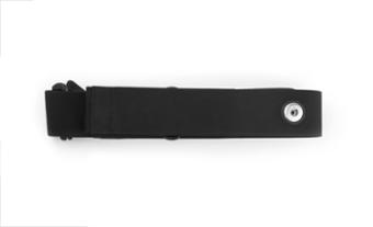

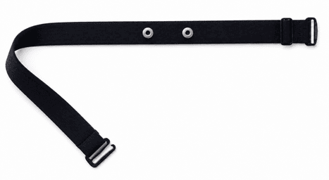

Q: How do I order a replacement or extra strap?
Please see the link below.  There are 2 different sizes.
Purchase M7 Strap Here
Also, please note straps and transmitters are quite universal.  This means that you may be able to use a different brand strap with the M7 transmitter.  You are not required to use the Morpheus strap.

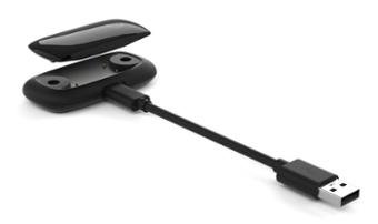

Charging Your M7
The M7 has a long battery life — up to 200 hours of use per charge.
You won’t need to charge it often.
Charging tips:
    • Charge it only when the battery drops below ~50% to maximize battery health.
    • If the battery falls to 10% or less, the LED will blink red when you snap it onto the strap (instead of the usual white → blue sequence).
⚠️ Important Charging Rules (Protect Your Device!)
To avoid damaging the M7, please follow these guidelines:
âś… Use only the USB-C cable that came with the M7 (or the same type of replacement).
✅ Use a standard 5V USB power adapter—not a high-speed phone, tablet, or laptop charger.
⚠️ High-power or “fast-charging” adapters can damage the M7.

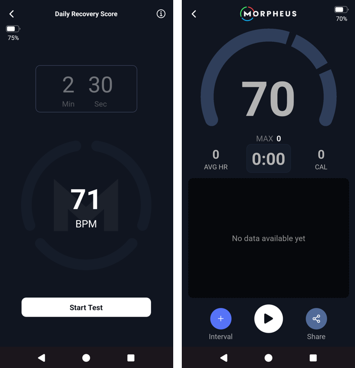

📱 Checking Your M7 Battery Level
When your M7 is connected to the app (before starting a Recovery Test or a workout), you’ll see the remaining battery percentage in the top left  or top right corner of the screen.

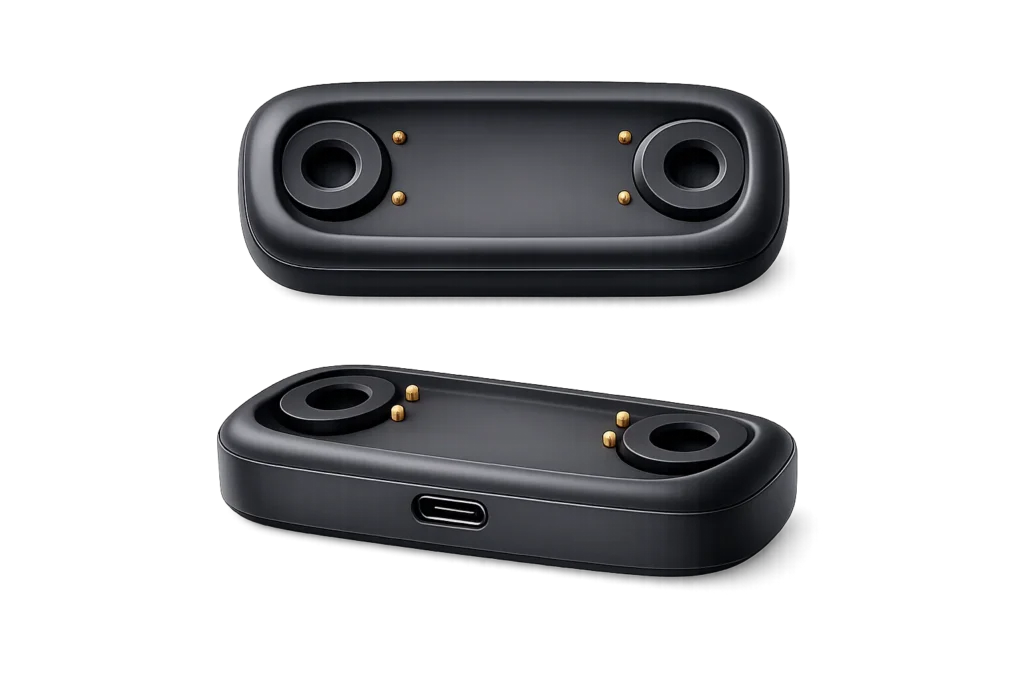

  • Q: Can I order a new charging dock for the M7?
Yes!  Please see the link below.
M7 Charging Dock

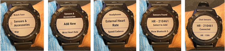

Q: Can I connect the M7 to other apps and HRMs?
Yes! The M7 works with:
  • Most fitness apps that support Bluetooth
  • Heart rate monitor watches and devices that use ANT+ and/or Bluetooth (including Garmin)
📍 If You’re Connecting with ANT+
Follow the pairing instructions provided by the device’s manufacturer.
(Example: Garmin’s “Add Heart Rate Sensor” menu)
⚠️ Important: Bluetooth vs. ANT+
Some devices (like Garmin watches) let you pair a heart rate monitor through Bluetooth or ANT+. Here’s what you need to know:
  • If you connect the M7 through Bluetooth to another device, the Morpheus app may not be able to detect it later, because it may still be connected to that device in the background.
  • If you must use Bluetooth, make sure you disconnect it when you’re done so the Morpheus app can find it again for syncing.

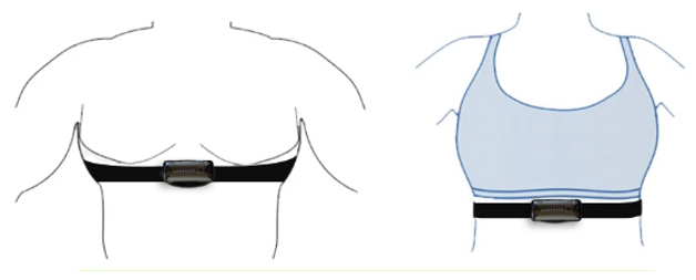

âś… Strap Placement
  • Wear the M7 just below your chest muscles, with the sensor centered over the bottom of your sternum.
  • Put the strap on first, then snap the transmitter onto it.
  • If front placement won’t work for your activity, you can wear it on your back (not on the spine). You may need to rotate the transmitter upside down.
Women may want to slide it a bit higher so that the transmitter and strap sits under a training bra, and that works very well for many women.

Chest straps don’t last forever. The materials (nylon, spandex, rubber) and the electrodes inside naturally break down over time — even if the strap looks fine on the surface.
When the electrodes wear out, they stop detecting your heart’s electrical signal accurately. If cleaning no longer helps, it’s time for a replacement strap.
