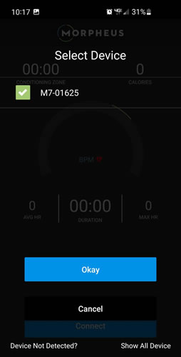

From here, you will hit CONNECT to pair the M7 to the Morpheus app using Bluetooth.
IMPORTANT: make sure that you are wearing the M7 to turn it on before connecting it to the app.

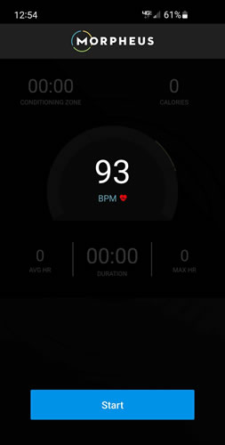

The M7 will show up with its unique 5-digit ID in the available devices list. Press OKAY to connect to it to the M7 and your heart rate will be displayed on the screen.
Hit START to begin your workout.

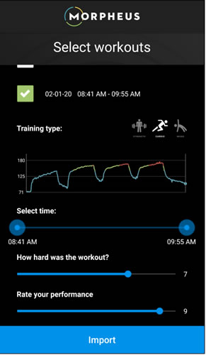

Once the M7 is turned on, open the Morpheus app and press SYNC from the main navigation menu and then connect the app to the M7.
This will bring up a list of saved workouts that are stored on the M7.
Choose any of the saved workouts that you’d like to import by clicking on the box to the left of the workout(s).
Once you’ve done this, you will see the workout details appear on the screen.
You can adjust the starting and ending time of the workout using the sliders.
You will also need to select a workout category and then use the sliders to rate how hard the workout was, along with your performance.
When you are finished, tap “IMPORT” to complete the process.
