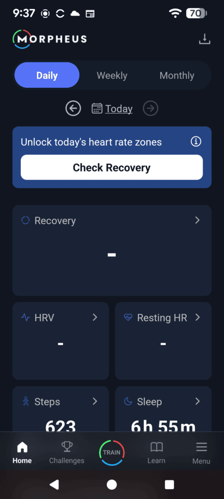

Tap Check Recovery from the center of the Home Screen

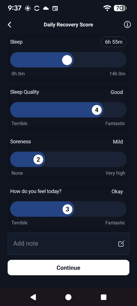

Recovery Questionnaire
Here you’ll enter:
  • Hours of sleep
    Note:  if you synced your sleep hours from a 3rd party tracking system, you will see the sleep slider bar already populated.  You can choose to change it if you want to.  Whatever is set on the slider bar is the final sleep data for the day.

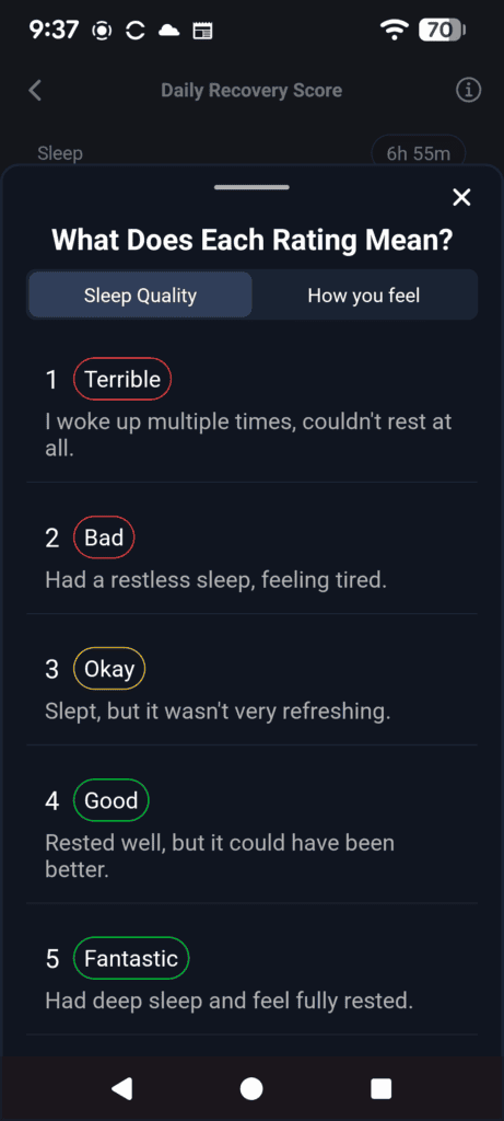

  • Sleep quality
  • Muscle soreness
  • Overall well-being
You can also add optional notes if you’d like to track anything specific.
If you are wondering which rating to choose for the Sleep Quality or How do you feel slider bars, tap on the “i” symbol at the top right of the screen for more descriptive text about each rating.
Once complete, tap Continue.

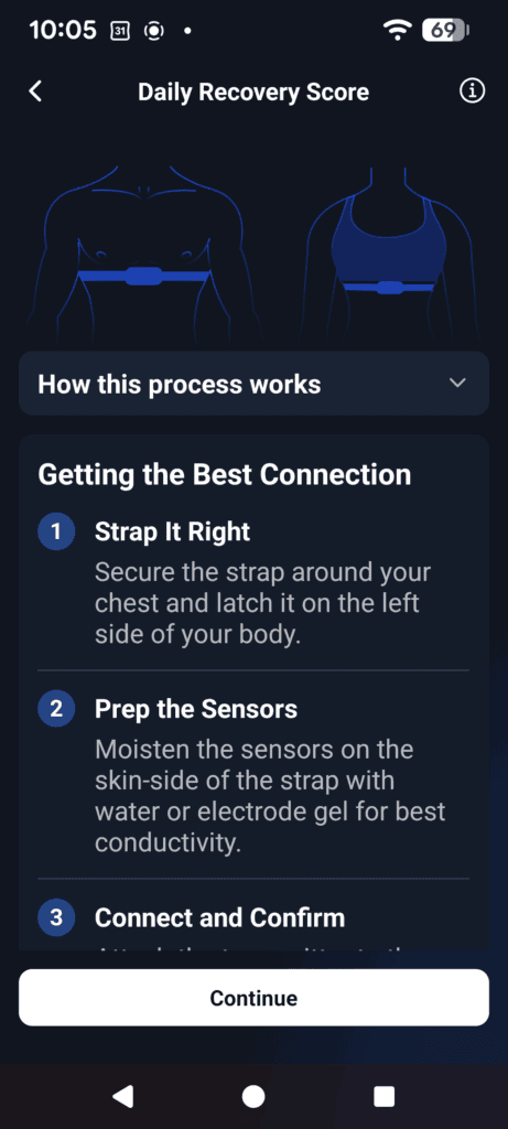

Turn the M7 On (Important)
The M7 only turns on when it’s being worn correctly.
  • Attach the transmitter to the strap
  • Put the strap on your chest properly
For tips on fit and usage, please review Heart Rate Monitor Basics .

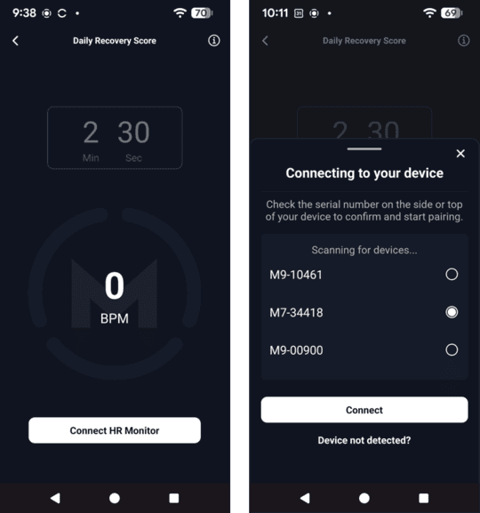

  1. Tap Connect HR Monitor
  2. Select your M7 from the Bluetooth device list
If it doesn’t appear right away, wait a few seconds for the app to detect it.
Each M7 has a unique ID, printed on the back of the sensor, to help you identify it if multiple devices are nearby.

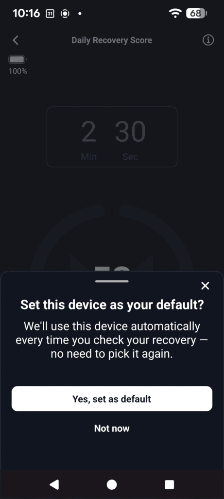

3.  You can choose to set this as your default device so that it will automatically connect each time going forward after tapping on Connect HR Monitor.

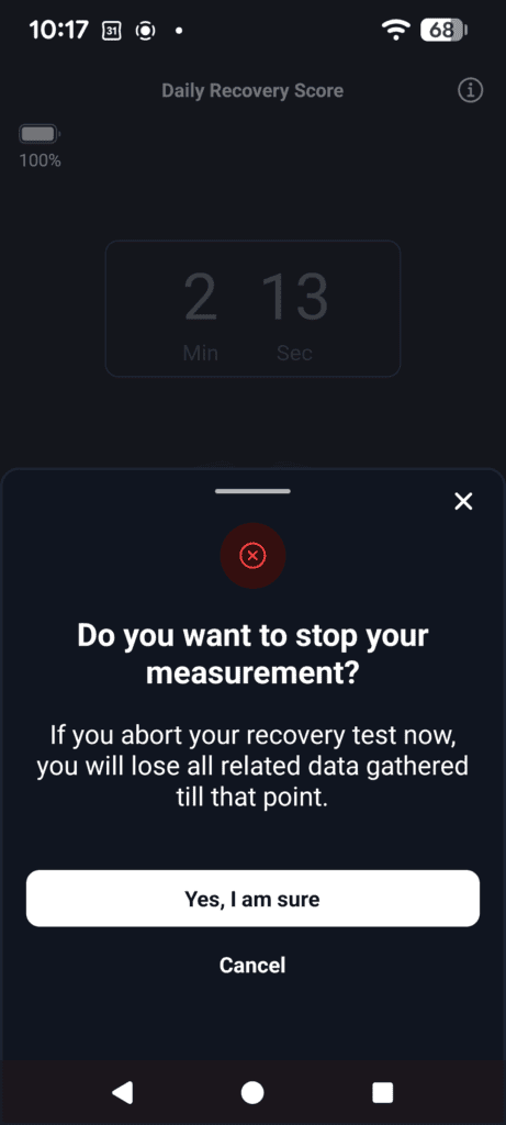

If for any reason you need to terminate the test before it has been completed, you can tap Cancel at the bottom of the screen.  If something distracting happens during the test, stopping it and then restarting at when the distraction has been removed, is the best way to ensure accurate data.
