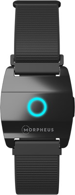

To train with the M9, simply put wear it on in the inside of your forearm, just as during the recovery test
Turn it on with the side button, and wait for the white blinking light to turn to a blinking blue light. This indicates it is reading your heart rate.
The LED light in the middle will change color to indicate your current heart rate zone.
Blue for recovery, green for conditioning, and red for overload. Note that your zones will update each time you take a recovery test.
